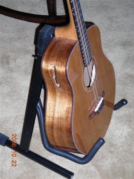

PostPosted: Sat Dec 09, 2006 5:31 pm

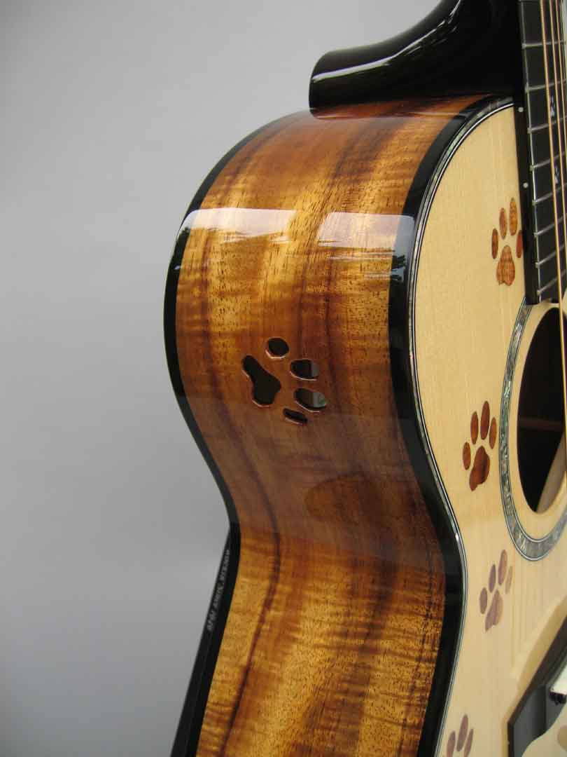

Soundports are kind of nice. They come in all forms.
here is one of mine.
PostPosted: Sun Dec 10, 2006 12:42 am
Andy, did you reinforce the paw on the inside?

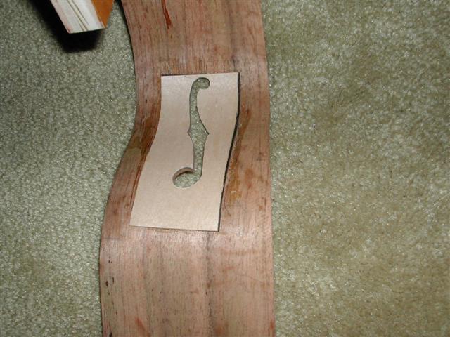

I love sound ports, and do believe it gives the player a 3D kind of sound to the instrument. I also think it increases projection too! This is just based off of my experience, and no statistical research to back it up. I always reinforce the area with a black & white veneer after the sides are bent. I know Paul Woolson does his before, but to me it was easier after. As long as you don't plan to bind the sound port after, you will be okay. I used a soft foam as a caul to glue it in the veneers.
Here is one I did on my bouzouki:

Lillian
Yes, there is a thin veneer of ebony
